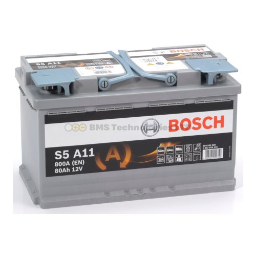

The current battery is a Varta 75Ah, confirmed via Carista last night. Carista can now "code" the battery to the vehicle. I was going to buy this Bosch battery which has the same physical dimensions but a slightly higher capacity at 80Ah - £140. I am aware that Varta and Bosch come out of the same factory. The Varta battery has a 4 year warranty whereas the Bosch has 5 years!
Any other top tips would be greatly appreciated. Thanks.
