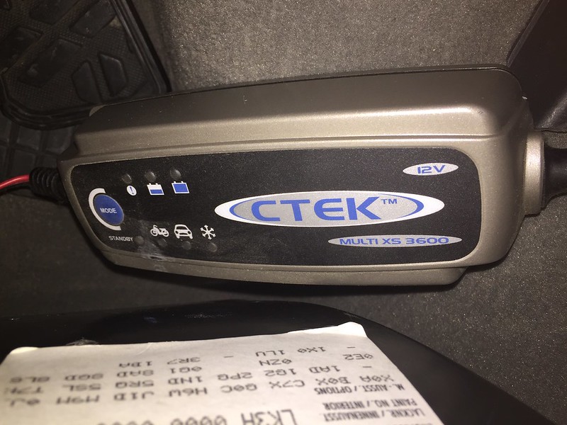

Great thread. When I bought my van a few years ago, the last owner had simply tucked a CTEK charger in the top of the footwell and I wondered why it was there until I realised the leisure charger didn't do the main battery. This one is simply connected the the 240v mains plug behind the seat. I like the idea of tidying it up like yours and adding a proper switch. Good job that lad

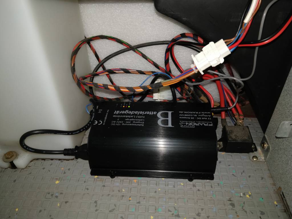

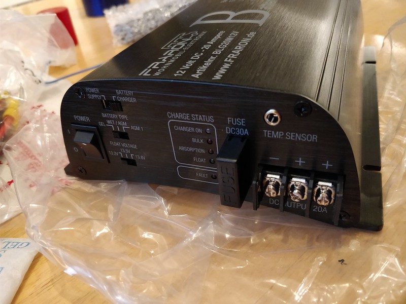

I've just bought one of these chargers from Fraron in germany which is compatible with the westfalia control unit and has dual output for two batteries.
https://www.fraron.de/en/a-85859176/
There was a link on another thread on here and i liked the look of it. I've seen far too many failures of the OEM charger so this one seemed to be the best of both. Plus I get back the CTEK charger from my feet.
Grosserfugunprice?
New charger in and running but I've still got to remove the starter battery charger and run a new feed down

So, I've bought all the kit as you listed, the charger arrived this morning - quite surprised to see that the CTEK XS 0.8 is described as a motorbike battery charger (admit I didn't see that on the ebay description when I ordered)??
Have I got the wrong one? Is this sufficient for the job?
Cheers
Matt
CTEK tech data says up to 100Ah.
Should be fine?
Cheers folks :thumb
Think I will return it and get the MXS5.0, long term its maybe the better option...
Cheers folks :thumb

But since then I've had to replace the leisure charger with the Fraron and so now I will first try routing the second feed on that unit towards the starter battery as that seems like a neater (and quicker) job...

Yea the Fraron May be a better job, no need to route a cable to the engine battery, just connect it to the engine battery cables at the split charge relay.

Mine was working fine. Gave it a good clean last year. It was chock full of dust and dirt. The vent panel is right by your feet in the exclusive. The fraron unit lied two birds with one stone. The extra charger I had for the starter battery was in a daft place near the pedals and I tended to kick it with my size 12's. Not a bad price either. I gave the old one away to another Norwegian Cali owner who brought up some wheels for me last year. Paid the favour back.

So I got around to fitting my CTEK charger today. I opted for the CTEK MXS 5.0.
I went down a slightly route than Sidepod, I just ran a cable from the circuit breaker and installed a socket beside the leisure battery charger, then just fitted the CTEK and plugged it in.
Where its located it can be viewed through the vent in the fridge panel.
Over all a very easy job.
