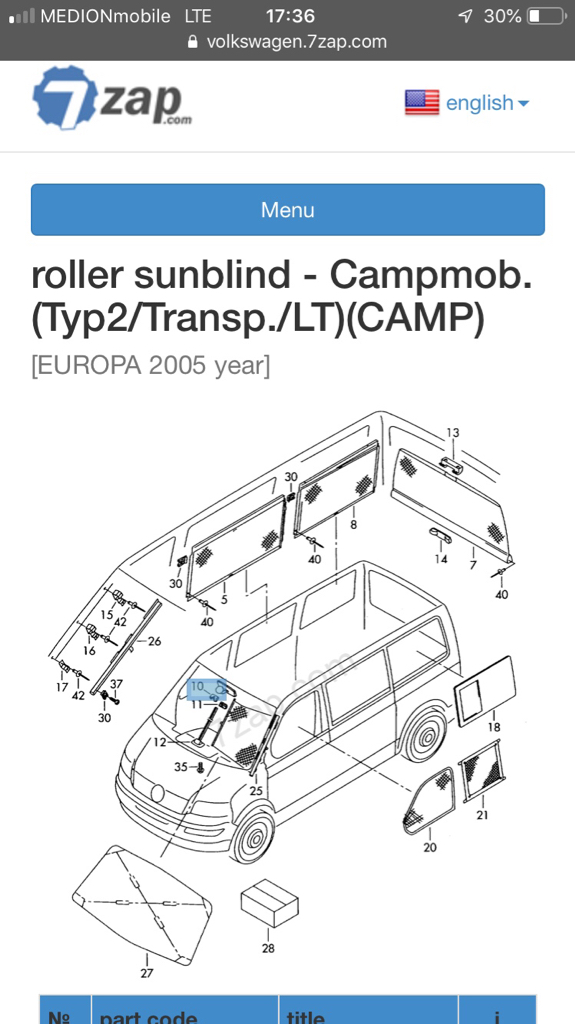

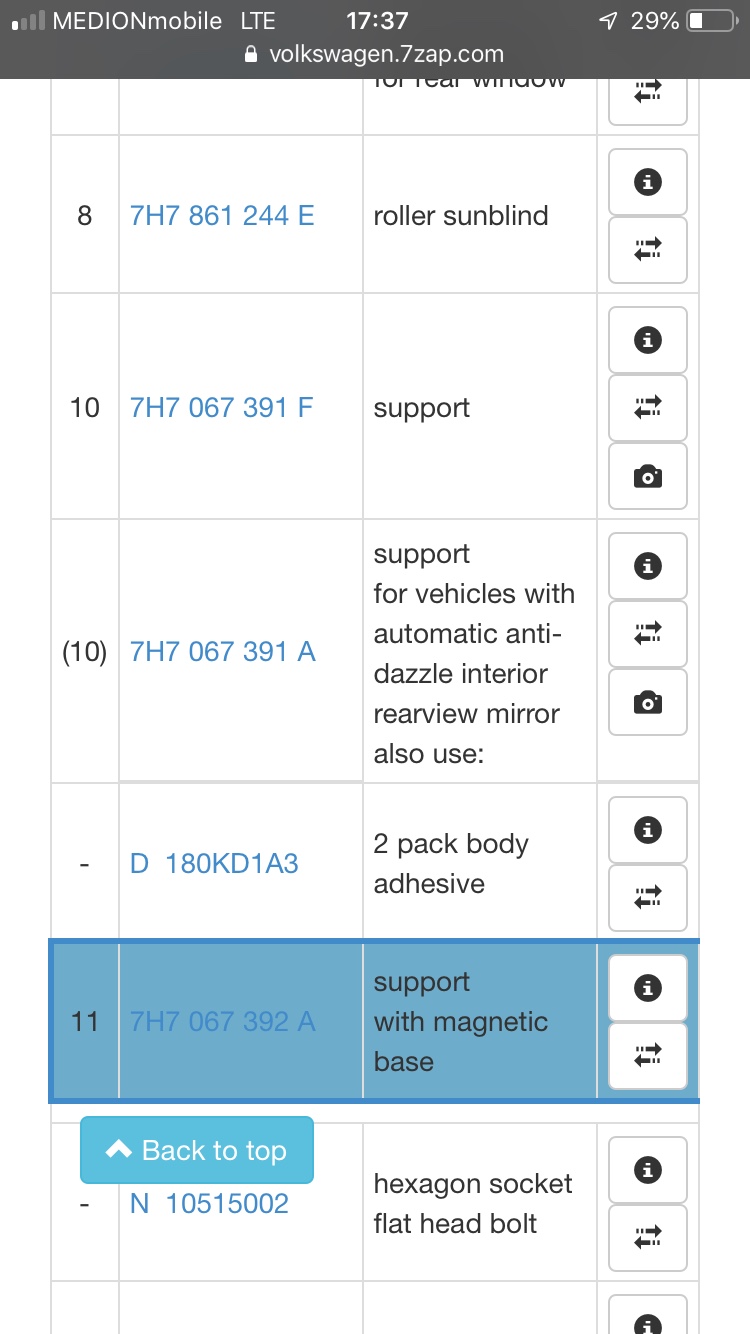

I know that this is an old thread but has anyone got a picture of the magnetic piece fitted to the bottom of the mirror please? I've recently purchased all the parts to retrofit, i know that they are not available in the uk, ive just come back from spain and saw loads but never thought about it until i was at the airport to come home:headbang
This may help your search (no 10 or 11)
Doesn’t really help much, I need to see where it fits to get the correct location, I’ve got all the bits and all seem self explanatory except for this bit to fit with the autodimming mirror
