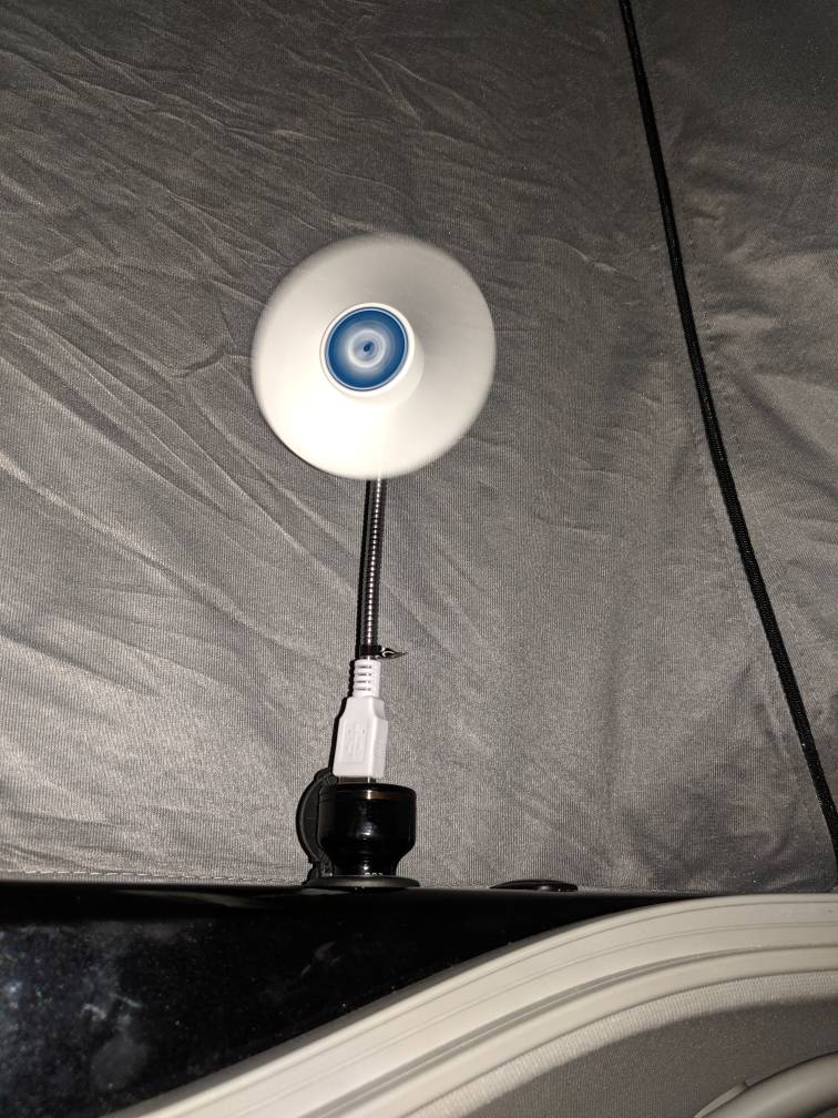

It's lovely and dark for sleeping. The colour in the day time is grey as in my picture (poor image but the only one I could find!) So not that dark.
