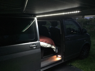

The rafter light is a wicked bit of kit too, looking forward to sitting outside at night with it on. :)
The rafter is surprisingly bright I did not expect that.

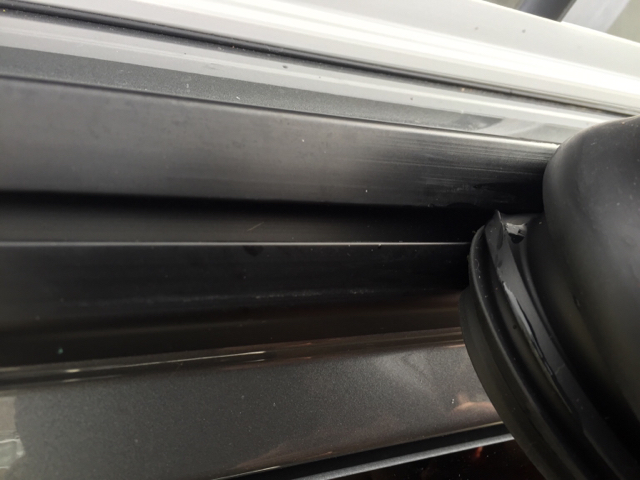

One tip. When fitting the rain guard, use the handle end of a spoon to push up the bottom part of the rubber into the channel. Makes the task much easier.

bending the seal back and pushing in hard with a thumb seemed the fastest method. This allows you to see if it was inserted properly as you went.
I’ve just fitted this awning today. Your pics really helped and the tip for fitting the seal was fantastic, I’d have probably resorted to a hammer in frustration if I hadn’t used your technique!
