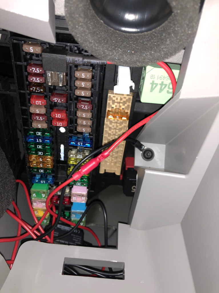

I fitted a Nextbase 512GW with a hard wiring kit into the fuse box under the dash. I too wondered where to get an earth from, when I noticed a screw holding the plastic trim in place was screwed into metal. I did not think it would work, but to my amazement the camera powered on ok! You can see the screw on the right of the pic. The switched live is a piggy back off the top fuse in the middle row.
