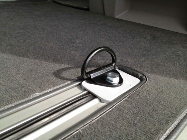

We have used a dog harness clipped to an anchor point in the sliding rail with a shortish leash that allowed the door to open keeping the dog inside or a longer leash allowing the dog to roam within 6' of the sliding door.

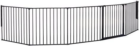

We have ten BabyDan playpen fence (including 2 gate) segments. We have used them to create a fairly secure garden area around the sliding door.

Hello BeeBee,
I was interested in your method of securing your dog's lead inside your California. I just have the rail in the floor along which the rear bench seat slides. What's the anchor point you use? Is it an accessory inserted into the rail? Grateful for your advice, could you send a photo of the internal fitting?

Yes, available from the Forum Shop and other sites.

The anchor is an accessory bought from the forum shop. It fits into the rail, we have ours on the rail nearest the sliding door. It fits in beyond the point where the bench seat will move to when the bed is down so doesn’t affect that. It was a wee bit of a ‘faff’ to fit as instructions where not completely ‘idiot proof’ but with help from forum this idiot got it done, so I’ld say anyone could. We find it invaluable both when travelling ( keeping dog tethered) and just in general short stops keeping him close to van. If memory serves ( bought it 3yrs + ago) it was, like all accessories quite dear for what it is ….. but good !
depending on the side of the dog. Wouldn't a small dog find its way to freedom escaping from under the van? Underneath the van under the sliding door?

Thank you for your suggestions, I have ordered an anchor point as they now have them back in stock, plus going to give the velcro a go for the G8 :)
