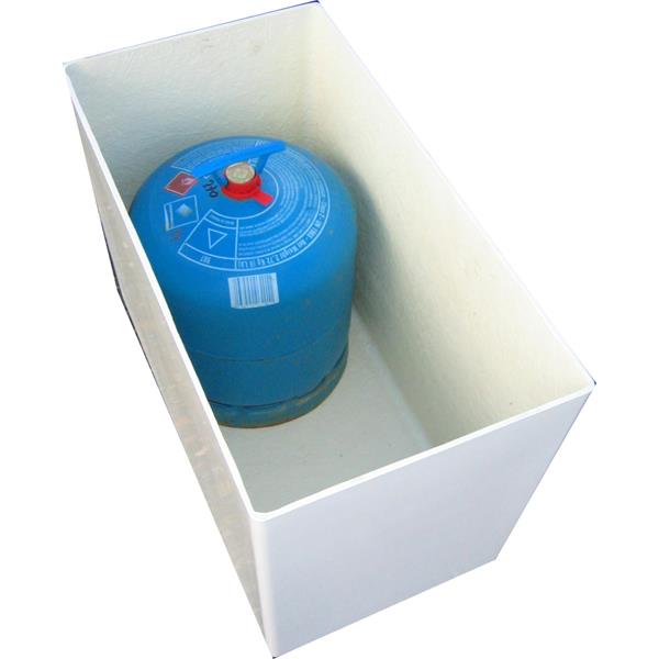

The middle crate for CampingGaz is a ridiculous price:
You could make a plywood one for a fraction of the cost.
