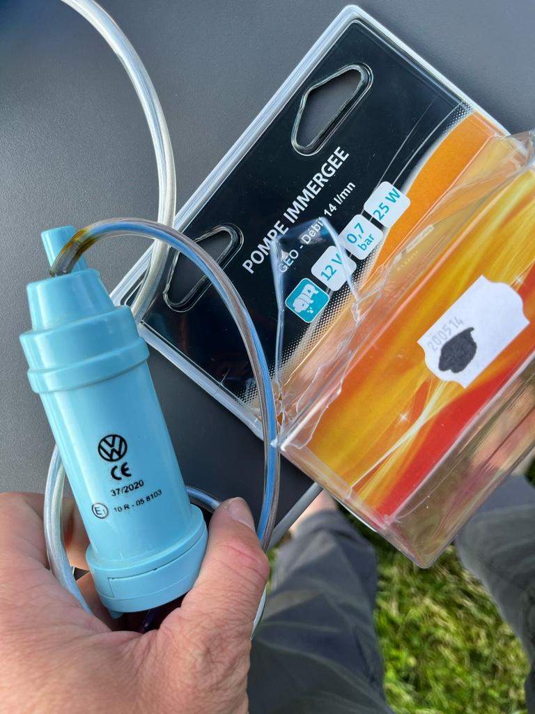

Thanks guys. I guessed right then. I saw it worked on the t6 and assumpted was ok with t6.1 too. It's not the case.
Do you know which is the consumption of the standard water pump to buy the right one?
Also maybe you know where i can buy the connector?
Inviato dal mio iPhone utilizzando Tapatalk
Solved with this
