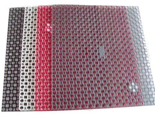

We also have an Engel, like you it was a carryover from our overland vehicle. We take it with us for frozen food and use the call as a fridge only but only need level 4-5 once the food is cold. Liquids take a lot of energy to cool down so we normally pre-cool stuff in the house fridge and transfer over then the call fridge normally copes.
One thing that does improve the fridge is circulation, so we have some plastic frost guards at the bottom and on the rear side.

+ Loz, thanks for the advice - thing that does improve the fridge is circulation, so we have some plastic grates at the bottom and on the rear side.
I have these as well but didn't mention as the fridge is empty. My main concern is keeping it cool as a fridge rather than a freezer maybe I need to 3/4 fill with chilled water and test again.
Hi Loz, where did you get your frost guards from please ? Nick.

Thanks for the info on frost guards Loz.
Hi Nick&Sara, I'm sure Loz will respond but in the meantime his frost guards look like mine which cam from VW Camper shop in Holland, not cheap for what they are. A search on the forum will show other methods used by members. This site is a real gem of information.
The rear wall one is €27 the bottom one €24 but is out of stock.
Hope it helps Ian
I got similar from a cheap shop that sold general goods, storage boxes, cheap plastic items etc. . It was for a draining board. 2 x £1 and easily cut to exact size.

Cheap alternative frost guards for the fridge: see post 44: The fight against water in the fridge

Over the last five years of Cali life we have not found we need frost guards as we like to have the Maximum amount of space available.

What is the purpose of a Fridge Guard ? Thanks
On the base to keep contents out of any water that might condense out and pool/collect in the base.
On the back wall, where the heat exchanger is, to prevent stuff freezing to the wall and also to allow air circulation and improve efficiency.
