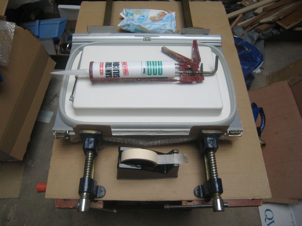

I have removed the fridge lid and hinge today and cleaned off the old adhesive. This took some time as the grey adhesive used by VW it is quite hard and needed to be hacked away, in the aluminium hinge channel, with a miniature chisel.

So I have giving it a go and put a small bead of silicon in the bottom of the hinge channel. Protecting the aluminium with masking tape and cardboard I rested the whole assembly on some bubble wrap in some sash clamps. Baby wipes were used to clean of any excess silicon that got pushed out of the ends when clamping.
Will know if it has worked tomorrow morning. At least silicon can be scraped out of the hinge channel if it does not work. ;)

that's very kind, it looks like the silicon worked. :thumb :D
Time will tell but at this stage the hinge is solidly attached to the glass top. :barmy
