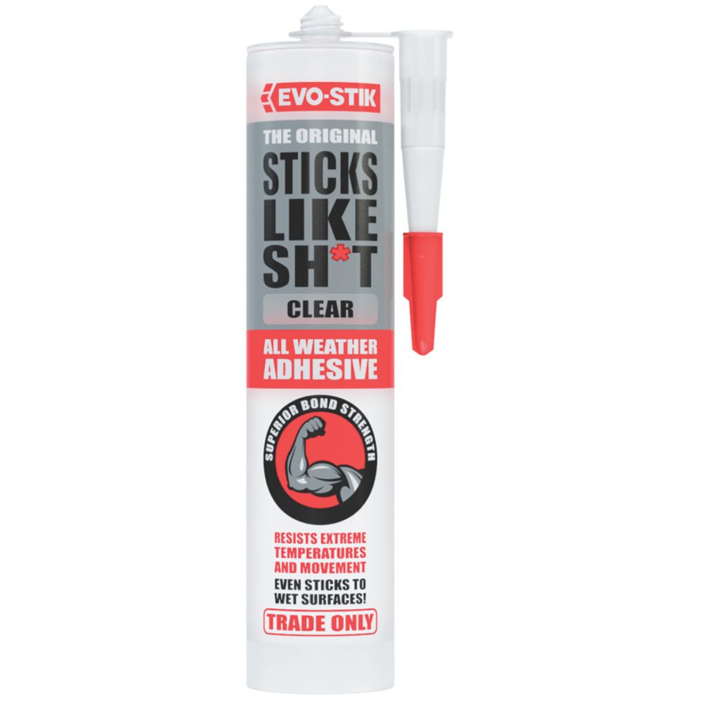

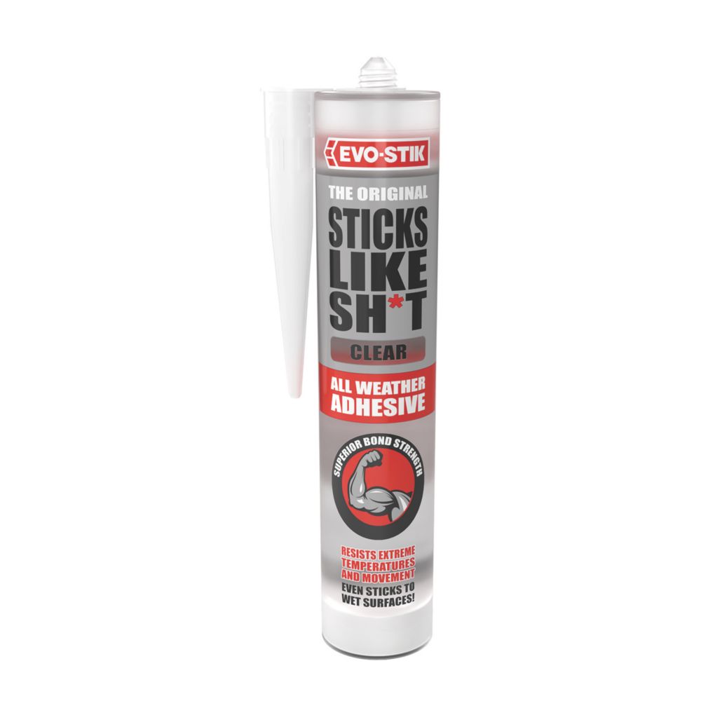

That's probably the best thing, i mean, it can't be user error or abuse can it.
You only lift it up and push it down.
If would have to fix it myself, i would use the best adhesive that's known to
mankind.
The tricky part would be to glue it in exactly the right place.
If it was a warranty claim it would be a new lid.
