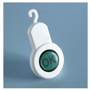

I have also had concerns over this especially when it is very cold or very hot outside as the fridge sometimes feels like it is not even turned on, so what I did was purchase something similar to this which hangs from the basket in the fridge and gives piece of mind for under £4
Fridge Temperature Monitor

I like the idea of the fridge gadget above..... so I've just bought one.
Thanks all for your kind help - have ordered one of those natty thermometers and will keep an eye on what happens.
