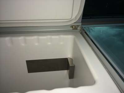

The fridge thermostat doesn't measure the outside temperature, it has a thermostat inside, to measure the inside temperature. That can be 'clogged' if e.g. if the fridge is packed too densely, and stuff is covering the thermostat.
The german Caliboard webshop sells a little coolbox optimisation thingy that you can place over the inside thermostat, to avoid this:
