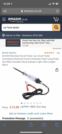

Not sure if this helps. I have a couple of accessories wired into this fuse board. They are connected to ‘switched’ circuits so only live when ignition is on. Hopefully you can see the piggyback fuse holders.
BTW I have a circuit tester which is perfect for checking on fuses i.e. ignition switched or always on. Worth having in your tool kit maybe.
