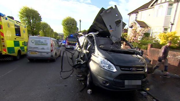

This story has just been on the local BBC website and local TV.
A van with a gas bottle in it exploded this morning in a residential area of Bristol. A man was slightly injured in the blast.
The other details are not yet available as to how the gas ignited but it looks like a fairly newish Transit.
When I get any more details I'll update the post.
http://www.bbc.co.uk/news/uk-england-bristol-39742493
Update on above story.
There are better pictures and more information on the BBC site now and it seems that the cylinder was in the back of the van and was leaking, it exploded as the driver got out and opened the door.
"A van driver and passers-by had an "unbelievably lucky escape" when a gas explosion tore apart his vehicle."

Another update from the BBC site
The explosion woke people in homes in Linden Road and Cranbrook Road, in the Redland area of Bristol, and debris was spread for 30m around the site. This is about a ½sq mile in area.
It is believed the driver was going away for a "rugby weekend" and had earlier loaded a gas barbeque into the van.
One woman who lives nearby, but did not want to be named, said the man was "one unbelievably lucky guy".
