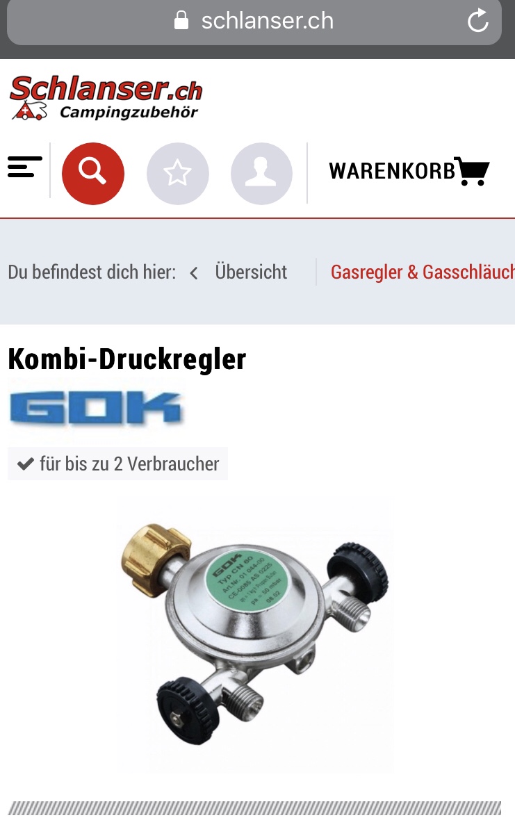

No expert here. Just found this picture. Is it this kind of thing? Found on schlanser/fritzberger:

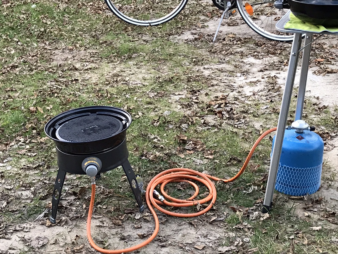

We use one of these:
