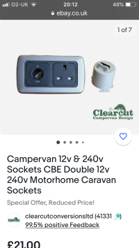

Id love an additional 12v power socket there, just bought a Dometic CFX3-35 which I plan to keep under the table for the Spain trip next month, and could do without running an extension to the rear socket.

Just a thought re 12v socket; put an adapter with in line fuse on a spur under the seat and replace the socket.

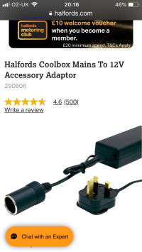

I think I would just take the easy option and use an adaptor with a transformer in one socket
