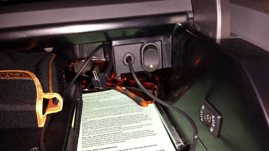

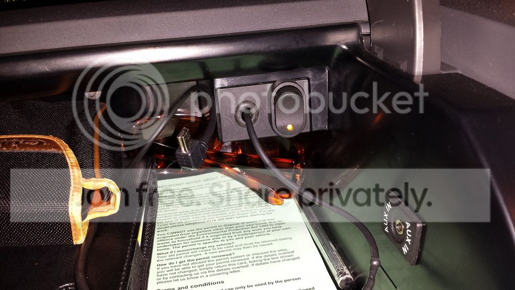

I had a sat nav hard wire power supply kicking about in the garage so I fitted it behind this box.
http://www.ebay.co.uk/itm/Hardwire-...860420?hash=item58b7af9884:g:4q4AAOSwkNZUkbxH
I use an airvent sat nav mount, this gets rid of the long sat nav wire dangling around the dash.
