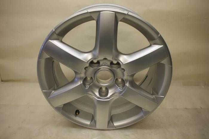

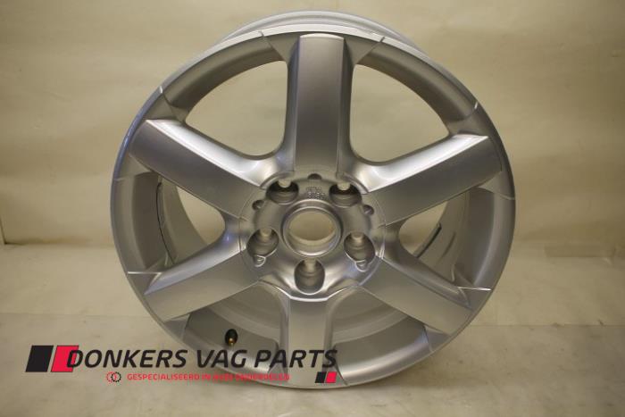

Found this which confirms T5 fitment but an 'old' wheel so possible corrosion, just double check. Low value.
