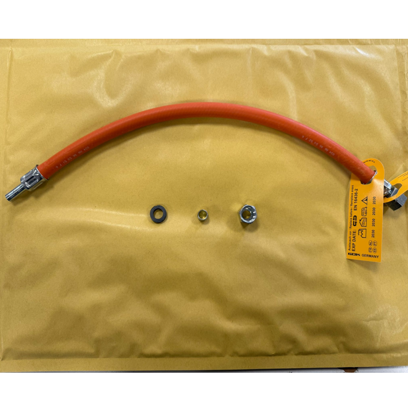

I am going to replace the existing regulator and orange flex hose for the propane system on my 2007 VW California.
Attached is an image of the existing regulator and I want to replace it with the identical regulator and hose.
Does anyone have any insight into a good place to obtain the right replacement from? We are based in Shropshire.
Thank you, Ian

Excellent question. It is complicated. The image is from a 2007 Mercedes James Cook that I imported to Canada this year. The regulator in the VW California is identical so I used this image as we live in Canada and cannot get access to the VW in England.
We have owner the VW since 2011 and never changed the regulator or hose. I understand that at 15 years old it is past time to replace.
Make sense?
Ian
