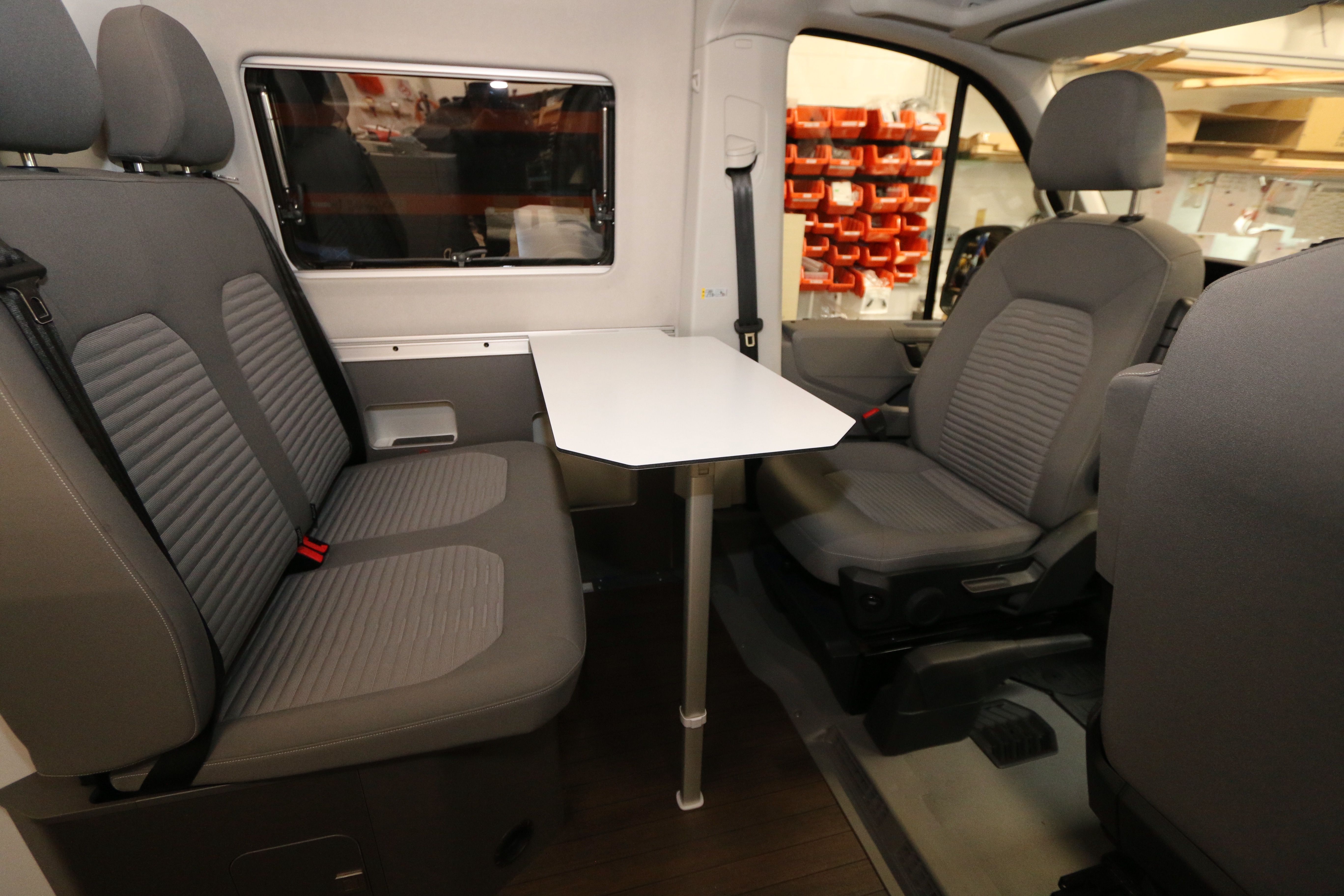

Same problem with joker, I was going to cut mine down but will be selling van very soon (new on coming).I have alway felt the internal table was to long, and a hassle to get around when trying to get to the passenger seat, so had it cut down and slightly reshaped. Still looks fairly original.

My effort slightly longer and leaving room to swing your legs under.A new table for the 680. I'm very happy with the proportions. I can now easily get into the front cab and we have more room to move around.
Jesper is that the original table modified or complete new unit? Also can you tell me where you got your fitted carpet in living area please? My 680 is due for build next week so starting to plan some purchasesMy effort slightly longer and leaving room to swing your legs under.
thanks Jesper will have lookI kept the original for safety but not sure why. The table shown is OEM Grand Cali spec. Purchased another from our dealership. Then to a local joinery firm who cut it down to where I had specified and to shape then re edged it. They will need a banding machine to reapply the white edging.

Forgot to add they cut a template.
