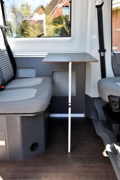

Got my table brackets 3D printed now ready to make my smaller table. Going 400x800 and an adjustable leg to allow it to also make a bed frame between the seats in due course.

I kept the original for safety but not sure why. The table shown is OEM Grand Cali spec. Purchased another from our dealership. Then to a local joinery firm who cut it down to where I had specified and to shape then re edged it. They will need a banding machine to reapply the white edging.
The carpet is great very versatile and hard wearing, got it from our local supplier. Look up Alternative Flooring but ensure it’s the rubber backed version which is synthetic and rubber backed.
Forgot to add they cut a template.

Well the OEM table if you don’t use the existing was £240 ish.
To cut down and re edge it at a joinery cost £70. The cut down IMO was the best choice for me as it’s not to large or small and easy to move around now.
If I were doing it again I would use the existing.

Wow awesome. I have the brackets ready and want to make the same. How did you cut the sandwich board, what type of screws did you use?

Below is list of items I used:
Important note the German site have stopped selling these tables as the bolt on the rail the latch mounts too has changed after 2021 apparently and if undone the nut falls off behind the vehicle trim to be careful and check your does not do this before buying all the parts.
One final note if I where to do this again might consider different material for the table as the 6mm is not the strongest and might be better to go with a 10 or 12mm board if you can find one.
