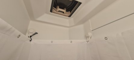

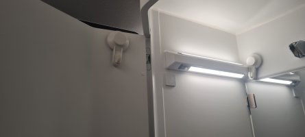

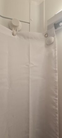

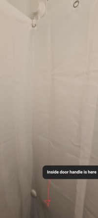

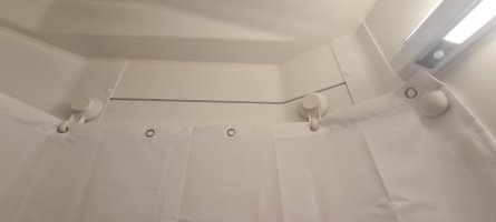

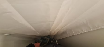

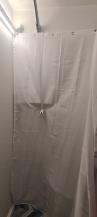

Bathroom.
Needs a shower curtain.......
1. Water runs out under the door.
2. Is the door under the sink waterproof?? Anyway water runs in there.
3. Easier to get a new shower curtain than.......

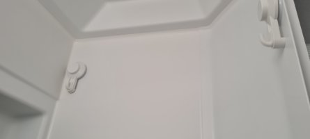

Shower curtain.
1. I installed a adjustable pole from IKEA just below the roof by the outside wall.
2. Also from IKEA the white suction cups on the left wall and above the door. the curtain rings slips in underneath = it’s easy to move the curtain out of the way to the right side wall.
3. The curtain runs along three sides except the right one.
Photo’s and IKEA info will follow soon.
