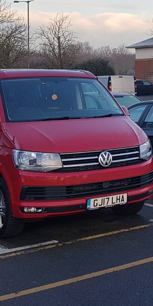

For halogens, black electrical tape - two small pieces over the part of the headlight that throws the light on to the opposite side. This is a small patterened glass between the high and the low beam lights.
When in Austria last year the traffic cops there appreciated my handiwork and gave me a thumbs up :)
Easy to remove as well - without any residue. Zoom n and see pic below - black tape on the headlights

Elmo, if you are taking a RHD vehicle to an LHD country, yes, you need to change the beam pattern. The headlight glass itself may not have any marking/pattern (see the pic posted by me above). The wide throw to the kerb side/passenger side is done by the reflector and does not need a pattern on the headlight glass such as was in older vehicles.
The eurolites or any other option (such as the black tape) blocks out the light throw to the passenger side - which, when you drive on the opposite side, without any light beam modifier such as eurolites can blind the oncoming cars on the passenger side lane.
Hope that clarifies.
