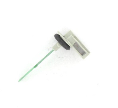

The sensor was from a eBay vendor:
Interior Air Temperature Sensor fits SKODA RAPID 2012 on Lucas 4B0820539 Quality
£19.02 - a bit more than you paid but it works, so all good with me. It looks like the part is a standard fitment on the entire VAG range.
