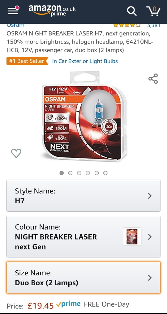

Probably a stupid question, but don't overestimate my intelligence! I decided to upgrade my T6 Ocean headlights to Osram H7 Nightbreakers bulbs, so bought a pair of bulbs. I have now only just realised that there are 2 x H7 bulbs on each side - one for dipped and one for main beam. I have replaced the main beam with the night breakers. I'm assuming that is correct, or should it be the dipped beam? Secondly is there any point in replacing all 4 bulbs? Thanks in advance for any replies.

Assume that you used the +150% bulbs.

About £20 and 5 mins to swap them.
