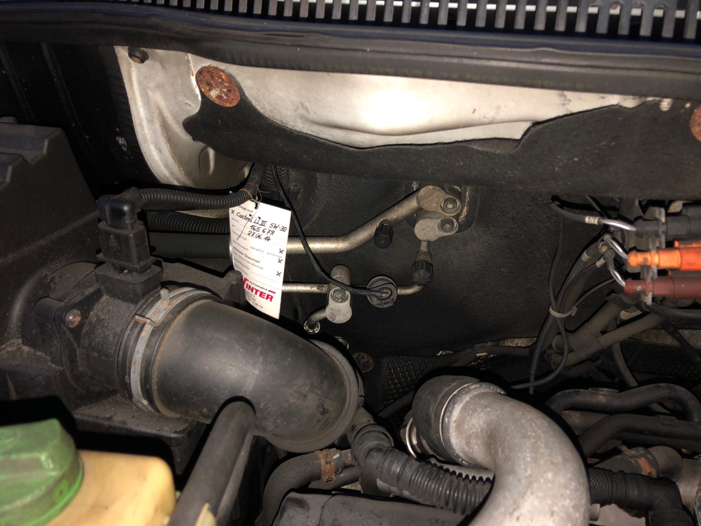

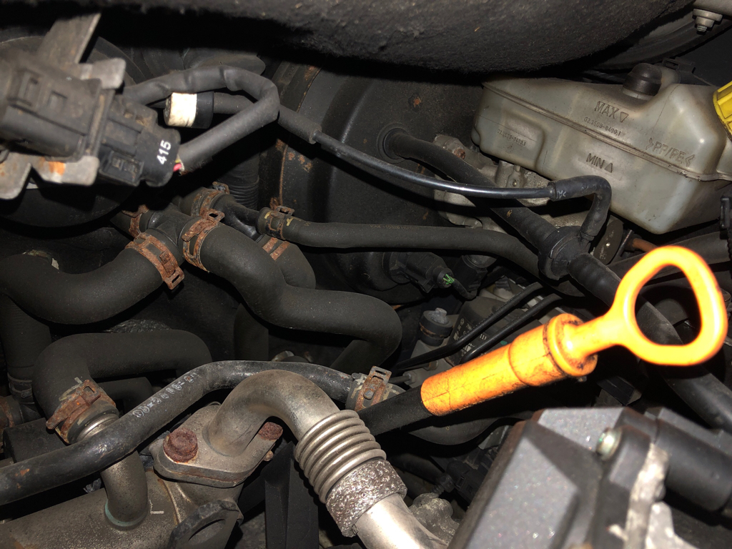

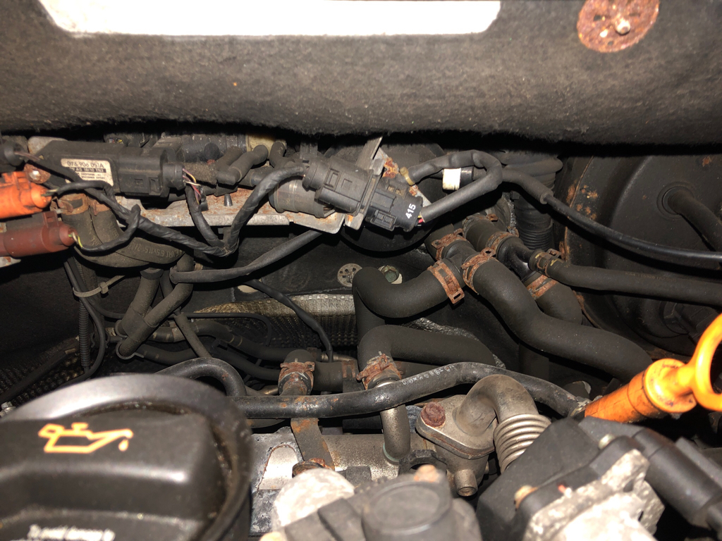

Are your front controls dual climate ? Really the only way I could tell if you have rear air con is by seeing the pipes under the Bonnet 0204D63F-D1C6-4BA4-9173-BD8D3ECA8A2E.jpeg
If there are two pipes you have front A/c if you have four pipes then you have front and rear. The standard set up is two pipes set horizontally if it has rear then the vehicle will have vertical pipes as well
Mine is a 2006 German import SE
I took photos of the whole bulkhead because I’m not sure what I’m looking at but I think the first one on the left is the two pipes you mean.

Hi ok so you definitely have rear a/c so the problem you have is with the flap control. Pull off the cover on the right rear it will reveal the rear climate unit. On the front there is a control motor with a white arm that moves the flaps. Pull off the arm from the motor and try moving the flap to see if the temperature changes. If it does then more than likely the flap motor has had it. Is the direction part of the rear system working?
