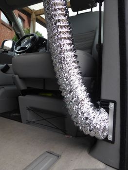

So the obvious solution was to fire up the webasto internal heater which did a great job of boiling me out of my lower bed whilst keeping it freezing cold up top. Does anyone have any creative suggestions of how to divert the hot air into the pop top and keep most of it away from the lower cabin?

There is a thread on this great site where some have used flexible ducting to route the hot air up stairs.

Here’s one of a few threads
Thanks, they help and put into pictures exactly what I had in my mind - especially the one with cardboard boxes and ducting :)

All you need it to do is go to B&Q or whatever hardware store, amazon has it too, get a 2m dryer hose , a rectangular connector for the dryer hose, some dryer hose tape, a small L shaped metal bracket and 1 screw+bolt to fix the bracket to the rectangular connector. 20 quid at the most.
If it's too much DIY ask your 6 year old niece , she'll do that for ya.
You'll sleep toasty upstairs, regardless where the hose is pointing. I hang it at bed level , pointing upwards, hanging from the rings of the safety net with some cord. Heating on 1-2.

I just got the tumble dryer hose and used some refastanable cable ties to secure it to the vent - in Braemar earlier this year it was -7 and the heater worked perfectly upstairs and down. Keep it simple!
Reading many similar threads eventually landed us to get one of these
https://www.amazon.co.uk/dp/B07QNZZRP7/?tag=eliteelect-21
for £7 (!!)
A big paperclip secures it to the top of the heater outlet and the pipe’s easily bent round the 80 degree vent outlet nicely, taking enough but not all of the warmth upstairs. Choose where you want to hang it, be it the grab handle or the top of the roof. The blower and heat rising brings the warmth up surprisingly well. When not stretched out it’s a small enough piece of ducting to be stored year round for that inevitable unplanned cold night. We’ve also got a pop top thermal Brandrup inner lining. A nightmare to install and expensive for what it is but it really does keep both cold and hot temperature extremes so much more tolerable.
