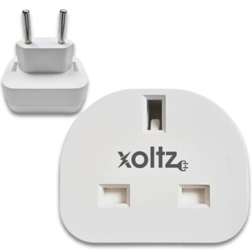

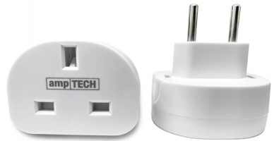

I have found an adaptor for this European Type C socket on Ebay.
UK to EU Euro European Plug Adapter, Travel Converter Adaptor Type C - £6.
Seems to work Ok for charging my laptop.
Nice find @DJDaniel . However, remember, don't leave that plugged in into the socket though. There is a small switch in the socket that then powers on the attached inverter. If you leave that plugged in, the inverter will stay on, and there will be a drain on your leisure batteries.
Take care.
Thanks for pointing that out @kurienp it would be easy to leave it in.
It does not make that clear in the VW manual, it only says there is a 'child protection switch' inside it.
I've just bought one of these and find that its a much more secure fit than the multi plug adaptor used previously.
