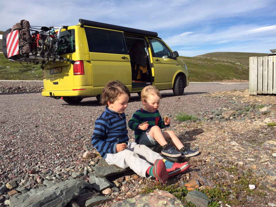

We carted two adult bikes, two child bikes and a two child Burley trailer around Scandinavia for 11 weeks.
Rail 1 - adult bike
Rail 2 - adult bike + front of child bike in middle of rack
Rail 3 - child bike + rear of child bike at end of rack
Rail 4 - bike trailer
The adult bikes are Bromptons, handles folded down and saddle dropped to keep them below the roof line.
Your problem is a little different, with four adult bikes and a child’s bike. Perhaps you could strap the child’s bike below the rack. But take note of the rack’s weight limit of (I think) 60 Kg.
A second alternative would be a roof bike holder.
