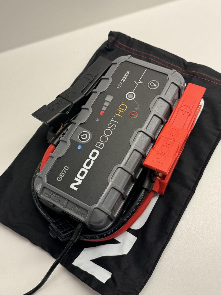

I have two Noco jumpstarters, a lighter one (Noco Genius 10) for my bikes, another one for the cars (Noco GB150).
Mind you: the garage used a jumpstarter; you asked one "also capable of charging our California": a jumpstarter is not meant for charging, but for helping you out in case of problems.
Noco also has excellent chargers, but these can't be used for jumpstarting. For charging, I prefer CTEK, mostly for "historical reasons": all my connections on the batteries of my bikes are standardized to CTEK.
For jumpstarting I would also recommend Noco. Not the cheapest but very good quality.
My six year old Noco GB70 is still working perfectly.
It was capable of starting my Land Rover Puma 2.2 diesel engine when that battery was almost flat.
I also used it a couple of times for starting Mercedes Sprinter diesels at work and it also works well on the old Land Rover TD5 2.5 litre diesel engines.
So I am sure it would cope with the Cali diesel.
The model I have uses USB or 12V for charging and has USB and 12V outputs. (The 12V in/out is handled by a cigarette type adaptor.)
I think the newer GBX models don't have the 12V out, but still have both USB and 12V in for charging.
The bigger GBX155 which we have at our sailing club has more cranking power if you want more in reserve.
Whatever you do, don't buy one of the cheaper 3 in 1 or 4 in 1 jump starter types. Most of them use 12V sealed lead acid batteries like those used as back up batteries for burglar alarm systems and kids electric toy cars. The batteries don't last long in my experience and can't deliver enough cranking power to spin over a cold diesel engine :(

You could get this with the optional jump cable (£30)? Good deals on Amazon under £200.
I use this to charge all our small items in the Cali it’s great. Use a portable (160w) solar panel to charge as well. Not sure what the power is like as jump starter I’m sure website will say.
Halfords do a really good lithium one, that also has a tyre compressor and lights. I’ve used it on my Cali to jump a flat battery with no problems
I have the GBX75. Excellent bit of kit but expensive.
I have a Noco GBX 55, not had to use on y cali, but there as an insurance policy, great bit of kit and tested it on a work colleagues car, who had battery issues.
Once after a very awkward, embarrassing incident not being able to start my car, I was helped out by a guy with a Noco jump starter. I vowed to not let this happen again, so I bought this one- NOCO Boost X GBX155 4250A ridiculously powerful and expensive but a great bit of kit.

I purchased a Noco GB40 as insurance due to an intermittent starting issue, and have had to use it to start the Cali on more than one occasion recently.
The VW handbook states that the negative lead should be clamped to an earth point on the van body, but the lead is literally just inches long and I can’t find a longer lead for the GB40 booster.
I’ve obviously boobed by connecting directly to the negative terminal.
So, what are you all clamping to, and have I done any damage using the negative terminal?
By connecting to the battery -tve terminal you bypass the battery monitor terminal so the vehicle doesn't know how much power has gone into the engine battery. So the system will be confused for a while. No lasting harm will be done.
You can put the -tve lead to any metallic part that is connected to the body or engine. You don't have to connect to the earth stud if it won't reach.
