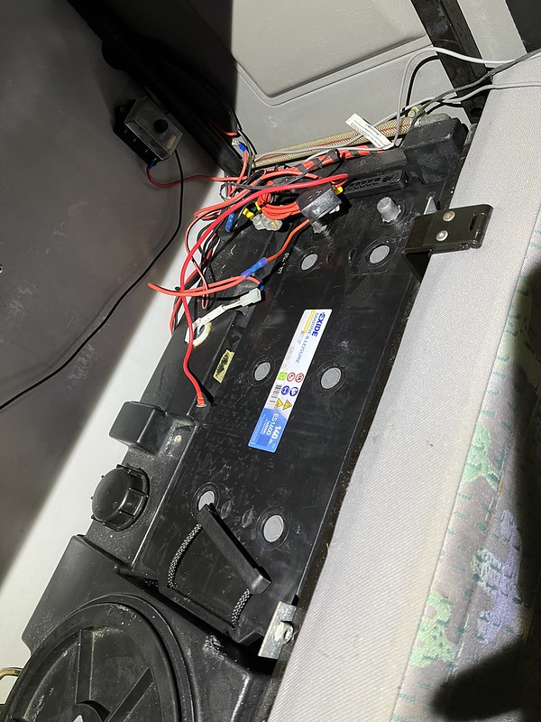

Has anyone on here upgraded the leisure battery in an exclusive to LifePo4?

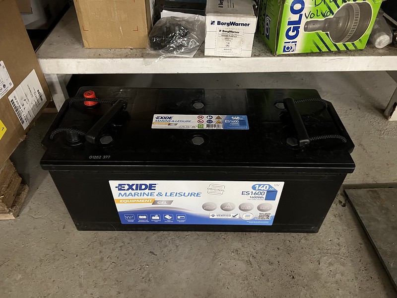

I've been looking at older threads to replace the original battery like-for-like with the Exide ES1600. I can get that in Norway these days for about £400 and would fit straight in.
I'm interested in this new LifePo4 tech and the space and weight a like-for-like battery would give. It's the expense that's offputting at the moment. As far as I've learned so far I'd need to ditch the old charge relay for a DC-DC converter. The charging temperatures for LifePo4 might be on the limit to where we are in Northern Norway which is what ruined my old battery. I've read some have their own internal heaters but how does that work leaving it for weeks on end?
If its too much chew, then I'll stick with the tried and tested gel ES1600.
Cheers
Matt

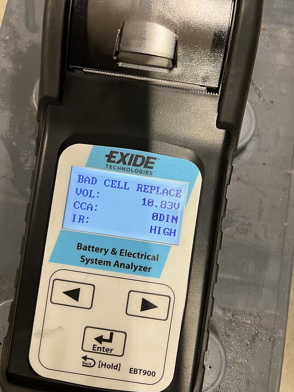

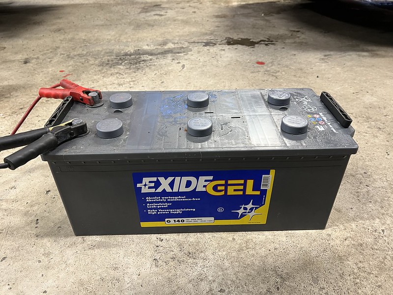

In the end, I think it's a step too far with cold conditions and the risk of ruining it seems to great for now. I was able to get the like-for-like battery through the garage a live on top of. Weighs a ton!
That was the old one. I thought it was the original Sonnerschein battery but It turns out it's been changed by the previous owner which isn't surprising. I left it sat a few times on a recon charge but it was still showing one duff cell. Never mind!
