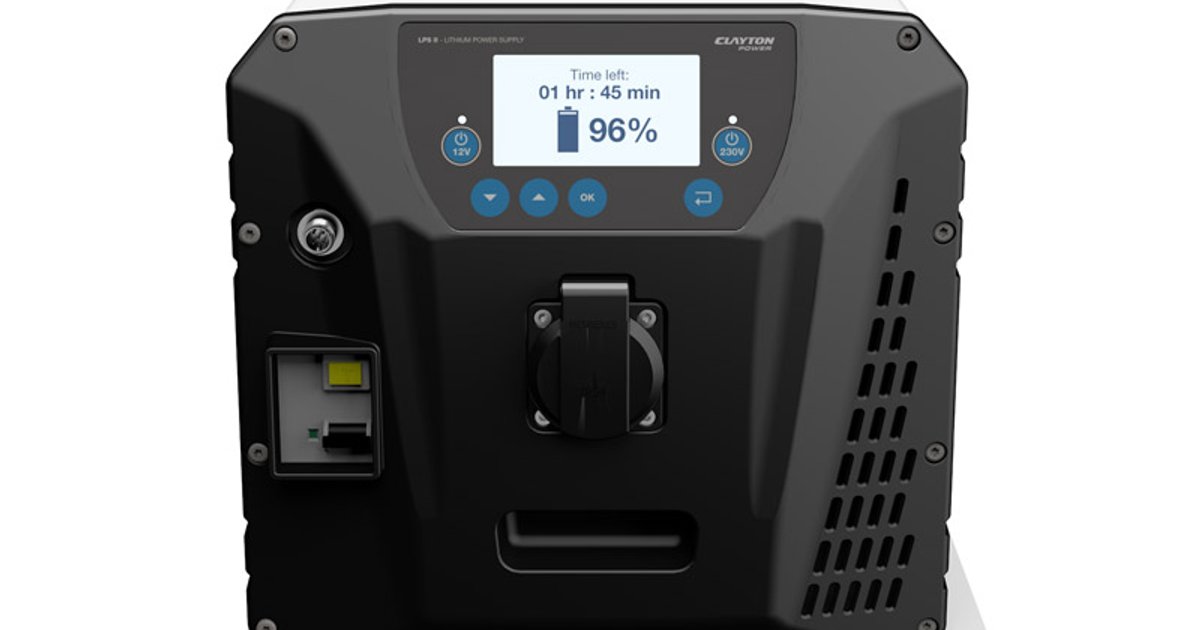

I received this device could I just swap it with my leisure battery?
You can, but I would disconnect the onboard Mains charger and possibly the alternator charging circuit until you and the company can confirm the vehicle alternator split charge system has the correct charging profile likewise the onboard mains charger.
You maybe able to replace the alternator split charge relay for a DC to DC system for lithium batteries.
Likewise the onboard charger may have to be replaced.
