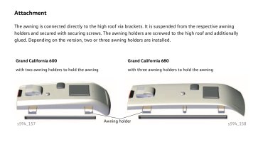

Regarding rail, I spoke to VW today and it turns out the fitting kit is actually glued in place, with the rail attached to the bracket – I would’ve expected it to be bolted on, to be honest.

Awning rail yes glued , but full wind-out cassette awning - more to it.
As for the GC 600 its the same for my Knaus 600. Long story - was sold with wind-out awning on, then on pick up no awning. So had to get the brackets from factory to fit. The tub top being different material - these are braced from behind the tub. So headlining has to come out and the top lockers, just to get the right access to place the brackets for the mounts.

That’s really interesting. I’ve been reading through the forum and I’m seeing two different takes on how they’re mounted.
Some posts mention they’re just glued on—even VW in Wales apparently said the same. But then others are saying there are mounting brackets that go in behind the headliner.
To be honest, I was pretty surprised when I heard they might only be glued. I’ve got one on my T25 and it’s bolted down.

The awning is bolted on. All GC’s are supplied from factory with the supports in place, see the technical documentation regarding this:
