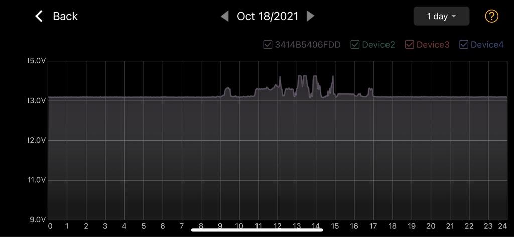

I have a 600 with Solar and the MPPT voltronic controller. I can confirm that the leisure battery does charge while the panels are getting sun. I have confirmed this by direct voltage measurement on the leisure battery. See attached for a recent day voltage trace. The van was unattended the whole time so the voltage fluctuations can only be solar.
The van was on hookup this whole time and the battery was already fully charged… whether one “should” deliver this much voltage to an already charged battery is a different question…..

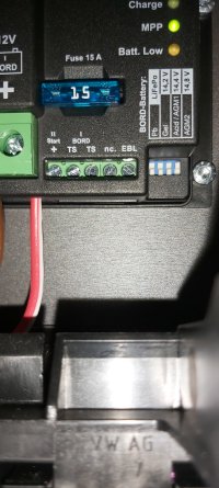

Here are some pictures from the Votronic Connector S-BC. It is just a cable from the Votronic MPPT (the red arrow points to the connector) to the Votronic Connector S-BC.
After the Votronic app is installed you just have to press on the small key (under the LEDs) and the device will connect to the app on your phone. That's it.
Here is a reading from this afternoon (cloudy). It is not a lot that comes in. During the "darker" times the solar panel is not that helpful.
With a 92 A AGM battery and no booster it remains to be seen how good the setup from VW is. I believe here is room for improvements. I need to make a list of things that I think must be changed / added, but I don't believe there are many companies in Ireland who are willing to work with me on the improvements of the GC 600.
