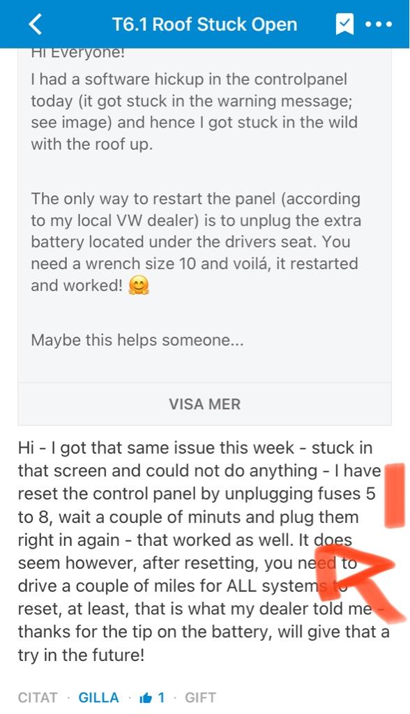

I had similar issues where resetting the top display (by removing the extra battery under the chair) fixed the issue every time.

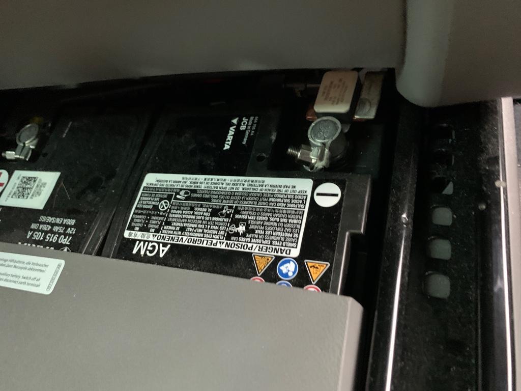

Any particar reason you don’t just loosen the screw here and lift the battery off and back on? It will restart the display

I also read this. Not sure if he’s referring to fuses under the steering wheel though.
