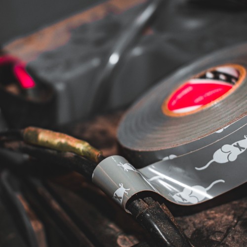

You can deter rodents from chewing wires by fitting anti rodent Tape, it is impregnated with Chilli extract.
search on line
I used this after it happened twice
Hasn’t reoccurred.
Hell of a job applying it. Drove the van up onto chocks and then wrap around all cables while lying under the van. Better than £500 a month bill.
Hasn’t reoccurred.

The tape worked for me but quite a DIY job. Garage may do for you.
Supposedly the wires contain Soy which the critters like a lot. If you search top right for ‘rodent’ you will find a lot of discussions and solutions v
Spray on anti rodent lacquer is also available.
Hasn’t reoccurred.
Sorry to hear of this happening, fingers crossed it continues to deter your local pests. Unfortunately it didn't work for me, after spending hours under the van wrapping everything in the tape, after about a year another (expensive) attack where they've chewed the spicy wire and had to have adblue and nox sensors replaced.

I've since spent more time underneath wrapping wires with metal scourers, zip ties and chilli. Bit of a mess
However I've not been able to do everything and as such just yesterday by exhaust system & adblue sensors lit up and I can see tubing under the van so another trip to the workshop awaits
I think only a physical barrier will stop them so without possibility of having a garage in London will have to make something to go underneath the van to stop them getting under there.
