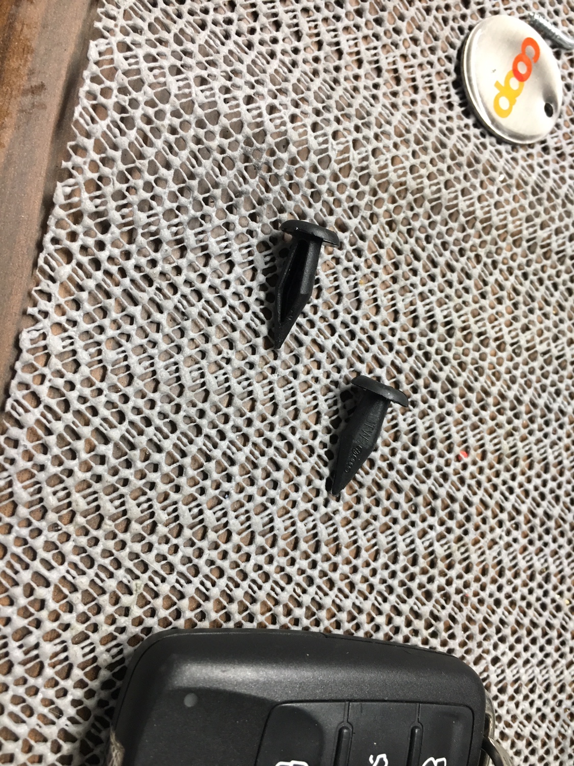

Anyone have any insight as to where these fasteners are used? I’ve now had two of them appear on the floor and I can’t find where they came from..

Where about did you find them?
I suppose there is no VW number on it? Like: 7H0 123 456 x ?
One on the floor in the cabin, and the other outside on the ground.. TW3 is marked on them but didn’t have any luck finding a location on a T6

These are from the plastic under seat carriage, they connect the rear panel together with the side panels of chair, normally come off when swivelling front drivers chair as can catch on front seat runners
In my Beech, theres a piece of fabric that is pinned to the lower section of the rear of the three-seat bench, which recently came loose from my heavyhanded treatment. They look like the pins used there too.
Voilà, one was from the back of the bench and the other from lower part of the RH front seat. Thanks guys
