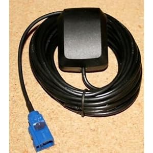

When you retro fit the RNS510, where does the satelite receiver go?
Are there any differences between factory or retro fit?
The Sat Antenna is the small beetle back/button type which can be hidden under the dashboard out of sight.
If you had a factory order then first and foremost it would be warranted for three years. The OEM antenna would be in the door mirror I think.
Other than that it's pretty much the same.
This type Phil -
Okay, I thought it might be like that, although I also expected it to need mounting on the dashboard, but if it can be hidden underneath, that's great.
