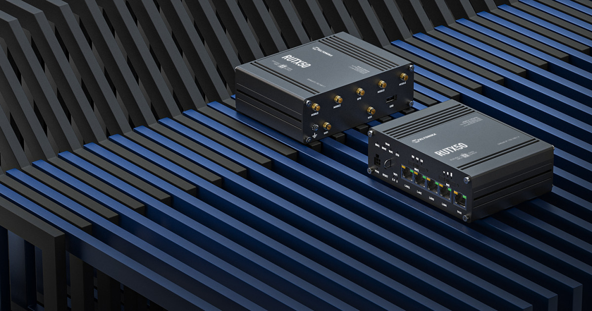

I can only advise upon the Wi-Fi and the answer is yes as the wiring is already in place under the driver’s seat and goes back to the control pane, you will have to run the antenna and cabling from under the seat up the B pillar to above the sliding door Which would be where the antenna would be mounted.
Personally I would install the latest 5G Teltonika mobile router.

The 5G Router looks great,would this unit plug straight into the loom under the seat?
Pretty much yes have a look on the Teltonika site as there is a connector block and loom for their router then just a case of activating it via the control panel, once activated you will be able to turn on and off via the panel.
