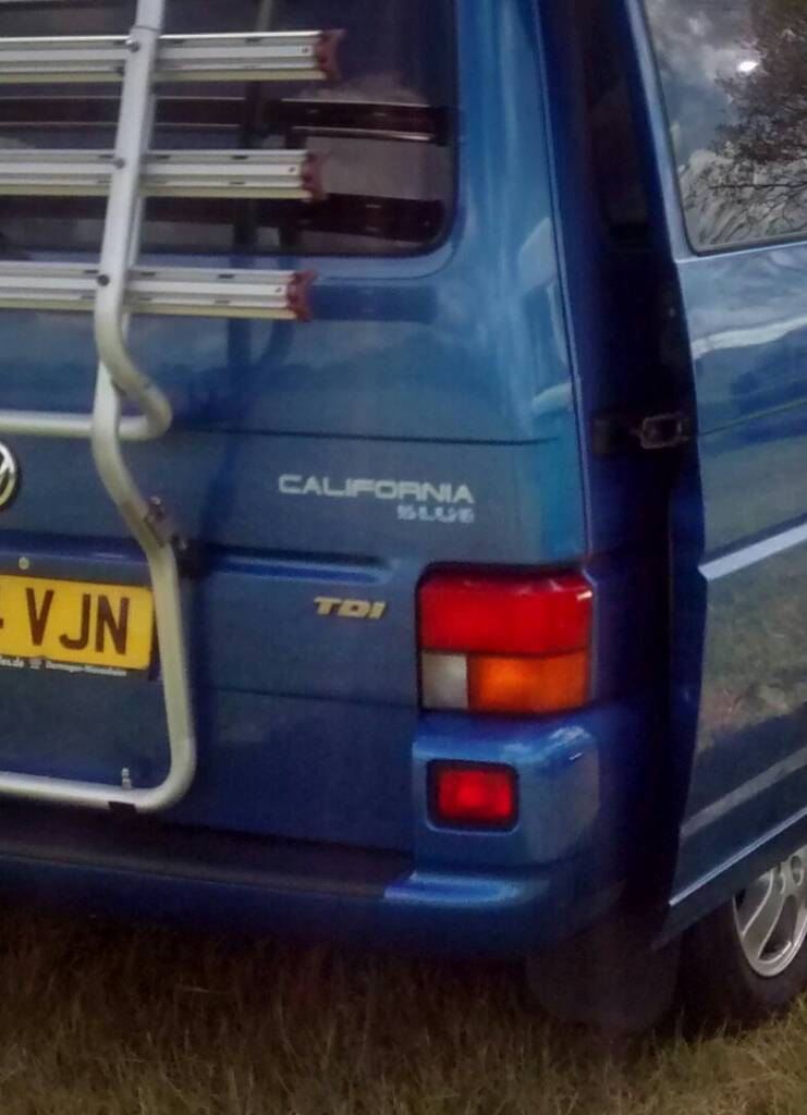

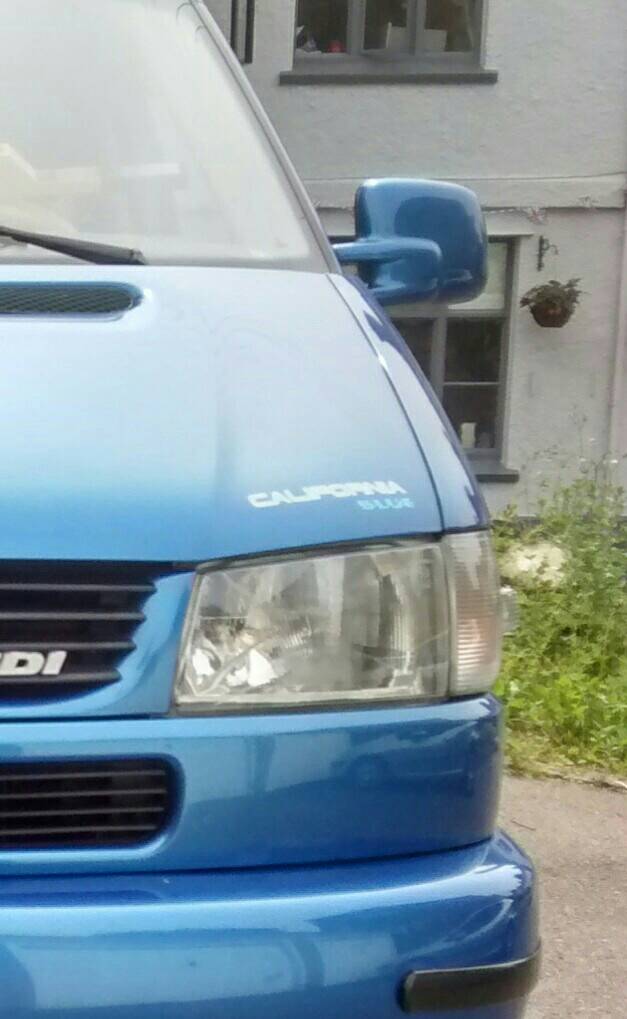

These are the decals on a Cali Blue. If it's had paint, they may have been removed. It certainly looks like a 'Blue' . Price is good if it doesn't need any major body work.
