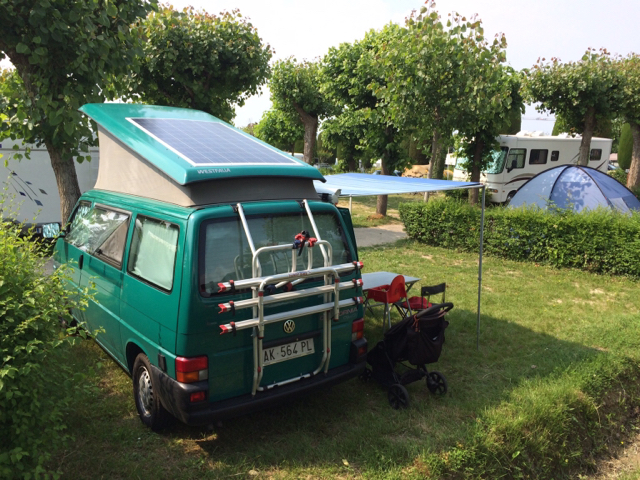

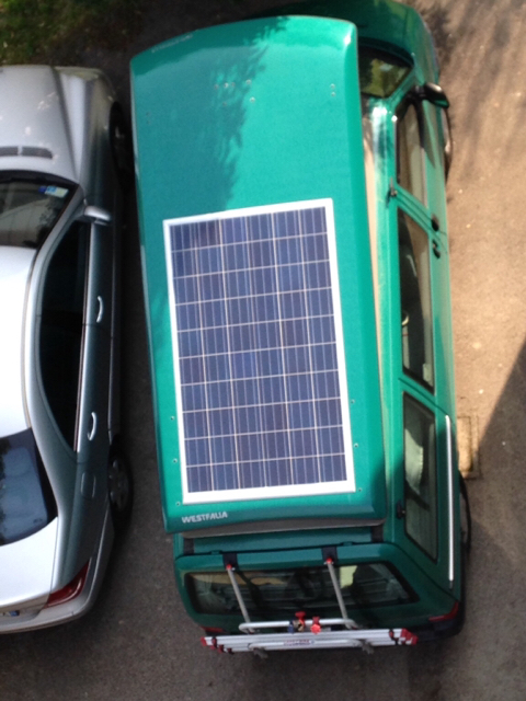

very cool - cant even see the cable ..... does anyone use a temporary flexi set-up where you deploy and plug in as required. i think a 100w output would do me fine .... but dont want it permanently fixed to the vanYes it was much than necessary. But it was great and beautiful. And useful. DIY. ;-)
Now 100-120w superflat, could be fine.

- Price difference is 153 euro here. That's about 40% of the price to install a solar panel. Or, if you look at it differently, the difference at 20C for CF35 vs CFX35 is 0.24 A which is 2.88W, so a foldable solar panel might bring it to similar levels. Something like this http://www.amazon.com/ALLPOWERS-Charger-Technology-Portable-Battery/dp/B00G6C5NR6/ref=pd_sim_sbs_86_3?ie=UTF8&dpID=51hdoaNa08L&dpSrc=sims&preST=_AC_UL160_SR160,160_&refRID=1B06D7GYXQYXPQCF0H8F
- In case of emergency you can always turn on the engine to charge the leisure battery.

I think I will go for a solar panel installation at some point, even though I have the hook up. The only thing that still bothers me is that it becomes a bit harder to use a roof box.
