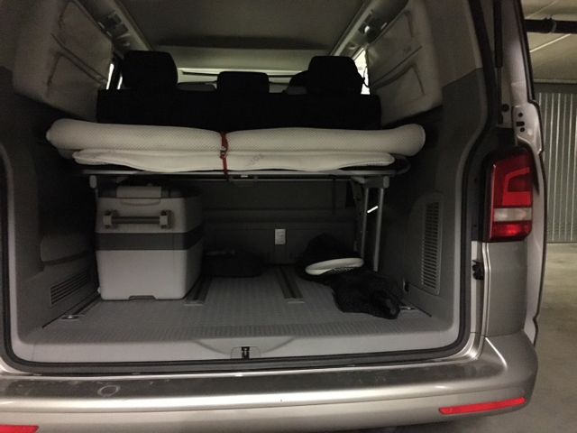

I have a CF40 Waeco:
We find it fits under the multiflex board on a 3 seat beach in the boot which is good, I hear it will not fit under a 2 seat version which has a lower bed.
We can extend the bed with the fridge in place on the floor behind the passenger seat but it takes up all of the floor space there making the use of the left swivel seat difficult.
We sometimes wonder if we would have been better with a smaller one as it is quite large but the capacity of the 40 is very nice and useable. We can easily fit milk, 1.5l drink bottles and plenty of food inside. It also runs from mains and 12v, as the beach has a smaller battery we tend to use mains whenever we can but run the fridge from 12v when driving. I calculate that the fridge should however work for 2 or 3 days on a 68ah Beach battery before running the engine or ehu would be needed, smaller fridges may last longer. The fridge does have auto cut out for low voltage to avoid damaging the battery, which is handy.
One thing to bear in mind, if we had an internal pod too, there would be no floor space left when the 3 seat bed is extended. We are still working it out though and I am sure we will find different ways of organising our beach.

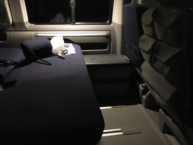

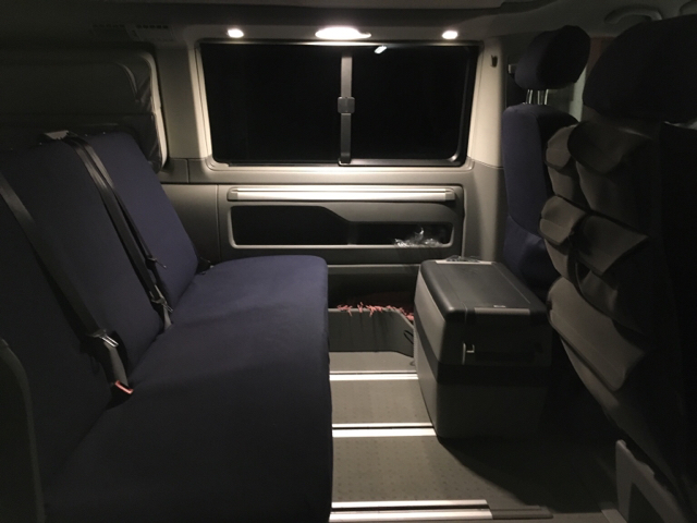

Here we are. Indel b tb 41! Beautiful italian product, webasto warranty, compact but full of space inside (almost 40 litres). It seems to fit almost perfectly behind the driver seat (continental, left side) and/or along the side under the window (left). Even with the bed done, is possible to open the lid, so is accesible anytime anyway. It is slim (35 cm) so that, in spite of the relevant weight, you can move it behind. We travel with the rear 3 seats bench, ready to become a bed, so it's ok. It is a huge object but fits perfectly in the rear, under the damned multiflex board. It works fine, finally, cast and a little bit noisy. In the California t4 it was the same so starting and stopping compressor (Danfoss) is a familiar noise, and Iike it! Finally: tecnology and compact dimensions are perfect, for us. 580 euros. We'll see…
Thanks again everybody, for your clear suggestions.

@MattBW do you know if the CFX 40 fits in the back under the multiflex of the 3 seater T6 beach, I've measured the height and it looks awfully tight!
My CF40 fits in my 3 seat beach T5, but I believe the CFX models are better insultated and maybe a little chunkier?
Happy to slide my CF40 in the van when I get home and give measurements and a photo

And now we tried our new fridge, IndelB TB 41: enough space for 5 (2adults, 3 little children), perfect dimension (it's big, but it's ok, in front of the rear bench (behind the driver, EU), but the best is energy saving: i set it on 5, the 4 and down to 3, eco running (always), almost 24 hours without hookup, result on LB: 12.5v. it runs only when needed, and so smoothly, you can hear starting compressor, but it's better and lower than old california (t4). perfectly cold beers and vegetables and milk and everything, and low consuption of the battery. really appreciate it.
only thing i have to find how to fasten, because it moves al little bit around the bend...but it's ok.
thanks for your suggestion, really recommended as alternative to waeco.
