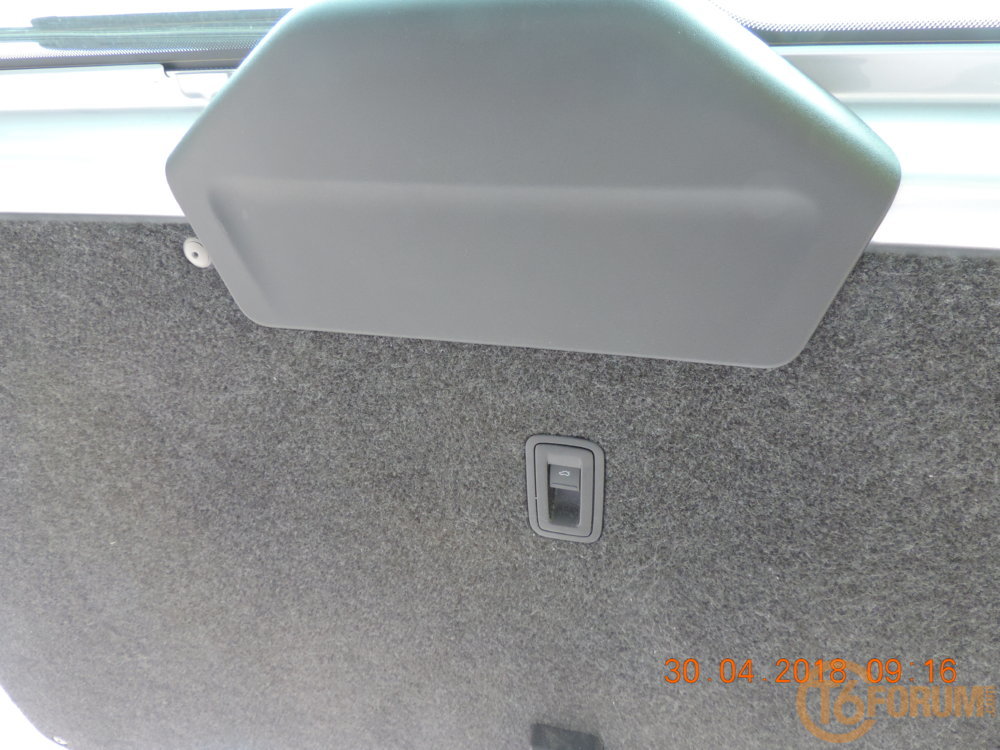

Is this what you want?
full
I guess the design of a California rear lid fitments may preclude this version but there may be another that is compatible.
It may be worth asking 'Pauly' on the T6 Forum (https://www.t6forum.com/) if he knows of a wiring loom and parts to fit this in your van as he is the guru on such things.
Rod
full
Rod
Thanks Rod. Yes I want that button, would be perfect! I was thinking I need a button that can't be accidentally pushed and that one looks like it lifts so bingo. So long as that switch is not too deep I could easily adapt it to fit the door card. Is that on a T6?
Yes, that is original VW fitment on a Highline '66' plate T6. 'Pauly' is your man on the T6 Forum for parts info.
Rod
Great. Thank you so much, I'll join and give him a shout.

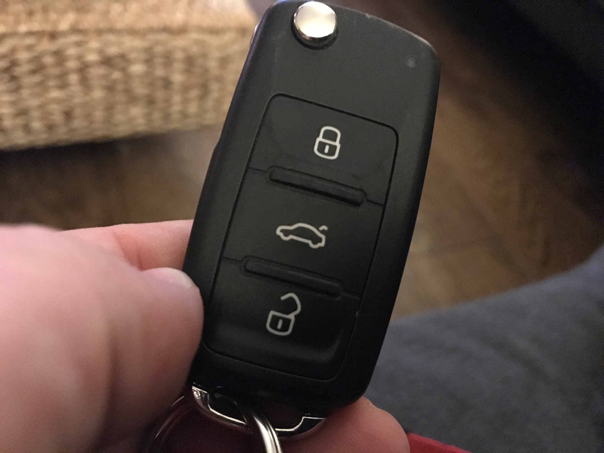

Sorry in advance if this is a dumb suggestion but what about using the boot lid opening button on the remote and giving the tailgate a shove from your bed... or does it not work like that?
Boy would I have felt silly if it did work like that. Had to go out and check. Unfortunately it only unlocks the tailgate for one opening then relocks. It doesn’t actually release it.
Note to self.. once switch fitted, never use that fob button and exit via the tailgate as would be locked out if I shut it.
Note to self.. once switch fitted, never use that fob button and exit via the tailgate as would be locked out it I shut it.
So if the Fob button " Unlocks " the tailgate electronically is there still a mechanical component to open the tailgate as in the other doors where you have to pull the internal lever as well?
No. Once button fitted... Just use fob to unlock then press button to release boot. Inside button does exactly the same as outside handle which is only a button / switch. Only thing mechanical in boot door is the electric actuator, latch and the spring loaded outside handle that operates a switch.
