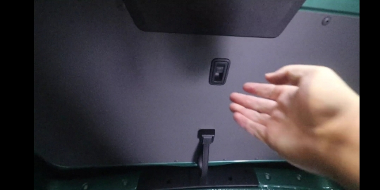

Thank you. Yes it is.
Would you post a step by step guide ?? Thanks
Basically it's take out chairs then undo every screw and fixing you can see inside. The centre of the plastic domed fixings unscrew then the whole fixing pulls out. Found a tight fitting Torx bit worked best. There are several torx bolts up each side with some having a felt pad glued over them. Once the centre plastic divider is undone you should be able to get the foam seat holders out. Once out I drilled a 16mm hole using a speed bit for the switch that came from RS Components Part No. 690-3255 in the area shown so missing the steel frame behind. From there fed some 2 core cable into the door cavity and followed existing wiring down to the centre bottom securing same with automotive tape. If you managed to get all the fixings off that secure the hardboard door liner then its just a matter of pulling said board away from door enough to expose the actuator and wiring. Then splice / connect the 2 new wires from new switch to existing 2 wires that go to tailgate handle switch (circled).
This was a not an easy job. Two of the bolts one each side would not come out due to the captive nut spinning and no way to grip them. Had to do keyhole surgery to make the connections and feed wire through as only had a small gap for access. If bolts had come out would have been way more easy. Very glad I did it as get great pleasure from pushing the button from bed and the tailgate opening to reveal the beauty of where I'm at. If doing this kind of mod is not your thing I'd recommend getting an auto electrician to do it for you.
Not really step by step but hope this is of some help.

From what I can work out if the outside handle of the tailgate has a keyhole as part of the external handle it’s a mechanical link. No keyhole then the handle is just operating a switch. Can hear the switch click when slowly lifting the handle in a quiet place.

Apparently this switch doesn't work if it is installed in the manner outlined in the thread above so will probably give it a miss.

I got round to doing this today. Been on my list for a while. Placed a switch in a similar place, as there’s a void beneath the roller blind for it, and it stops anything in the boot hitting the button by mistake.
Just need to reach behind the cupboard when in bed.
As stated. It’s quite an involved job. I wanted to add a light strip into the tailgate too, just need to figure the power source.
