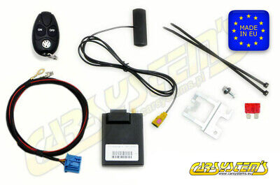

Have a read here. I think it does work on the T6.

The kit shown in the link above, is it just plug and play?
The link gives me the impression its the telestart radio unit just to add the remote and not the reflash as mentioned earlier?
I contacted the company but didn't get a reply yet.
Can't edit the above post.. Just realised the link above might not be correct. There is a seperate T6 section on that site with totally different modules.
