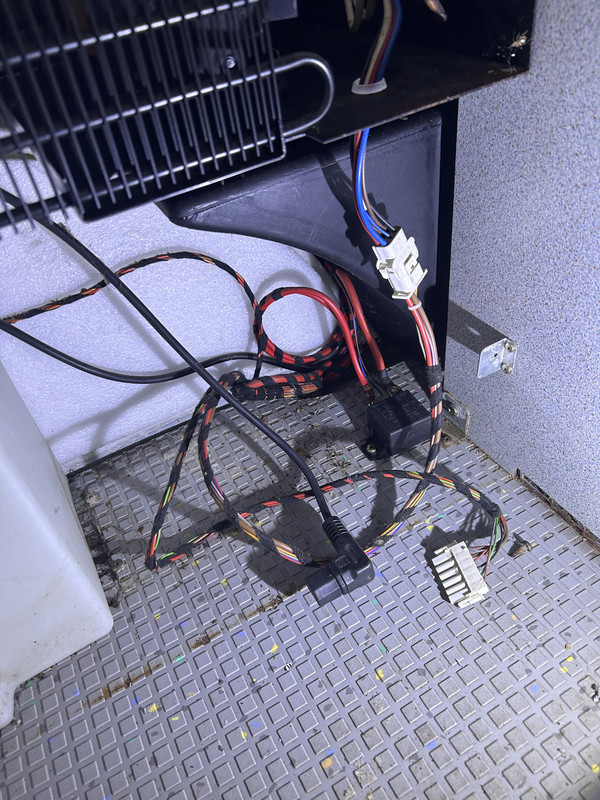

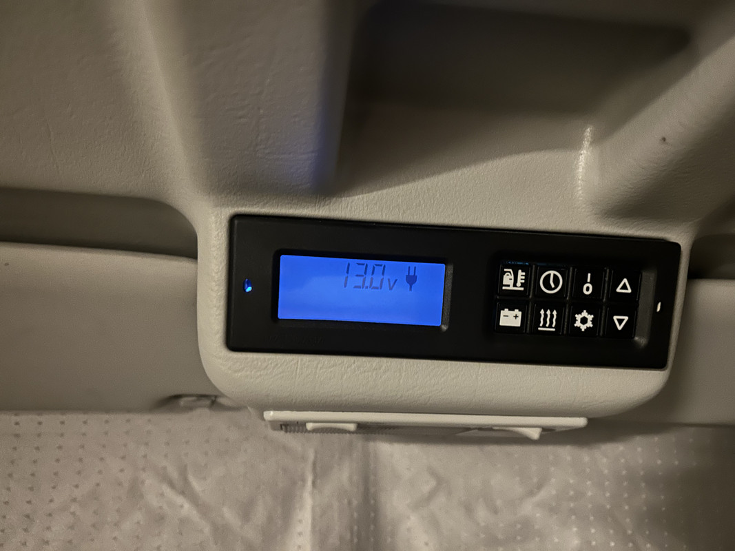

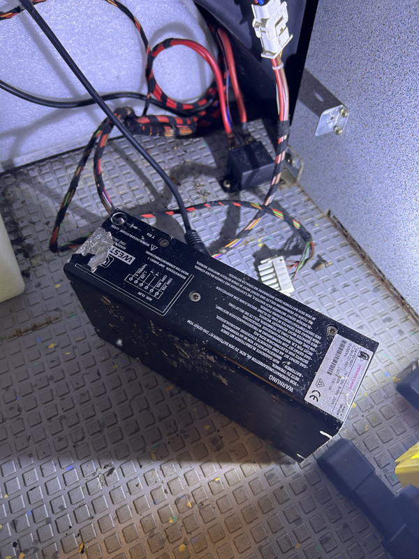

Started stripping things apart mainly to clean up and familiarise myself with the electrics and test the circuits. When I plug into the mains I get the symbol on the display, great I thought, it works! Then slowly the voltage drops (as pic below) then symbol disappears, no visual signs of a burnt charger but clearly it’s not doing its job

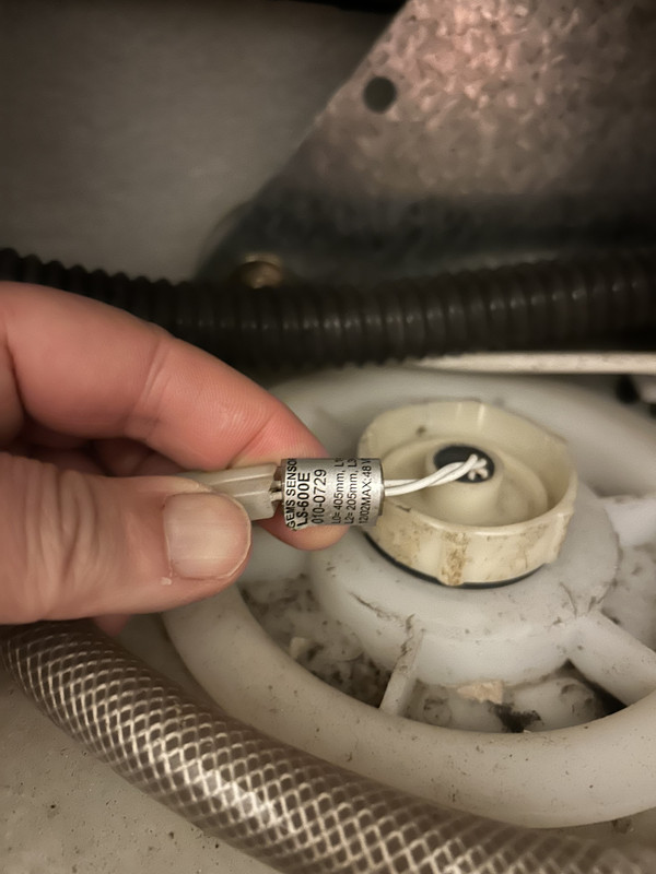

The water level indicator also doesn’t work, the sensor is made by Gems who I have dealings with so have asked for a replacement. In the meantime does anyone know how to remove it? I assumed it screws in but that doesn’t work and i didn’t want to break it

In the meantime here is the display, when hooked up to mains display shows 14v then drops steadily….
Fortunately FraRon now make a replacement battery charger that uses the original Westfaila plug, so I’ve ordered one up and given the battery a deep recycle with my C-tek charger just to see how long it does last before getting a new Exide replacement
Hi great looking van.
