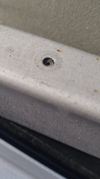

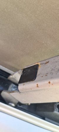

How many of these are required?
I bought two, fitted two.
Have spotted two more vacant holes (with old witness marks).
Assuming four should be fitted?
Thanks
VW didn't seem to know.
I'll attach some pics of where I think they should be fitted on the weekend.

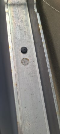

Well it's a few days until the weekend.. found this pic, so I've added to bumper grommets one each side at position #1
But can see witness marks suggesting that there should also be 1 fitted at position #2..?
The Parts Diagram shows Position 2. This would provide a Stop Buffer between the 2 struts.
Position 1 would act as a spacer between the strut and roof which could be problematic.
It is described as a Stop Buffer so designed to stop the strut at a set point.
