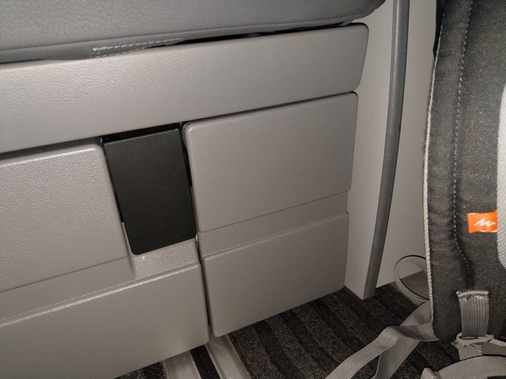

I too had an annoying rattle that sounded like it was emanating from seat mechanism. After many failed attempts to locate it, I finally discovered it was the plastic trim to the passenger side of the seat drawer, bit of elephant tape on the back sorted it!
Sent from my HTC U11 using Tapatalk
4NTS - is that the plastic that covers the extra storage next to the drawer? Will take a look at mine
This bit, to the right of the drawer handle
I lost that bit in the first two weeks of ownership and not missed it since
How did you lose it .. Quite big
I took it off for an obscure reason that I have since not been able to recall.
Being a two-left-hands mechanically dyslexic idiot I could not get it back on so left it in Alberts cupboard along with other bits such as the slow cookers I never use, the plastic beakers I can't stand, the seat covers that I got sick of sliding on .....
And, well, it's in there somewhere, I think, just never been seen again.
